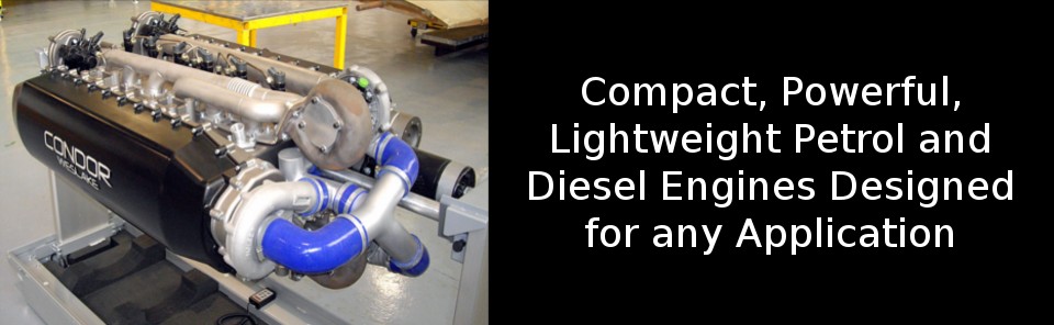

Pres de France, en UK (TN35 4HT), WESLAKE ENGINE (DIESEL !!!)
http://www.weslake.eu/news/newspages/AirShow.html
http://www.weslake.eu/news/newspages/dieselareoengine.html
